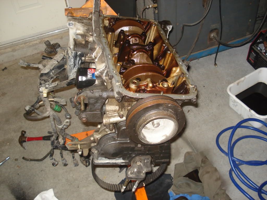

#148739 Well here it is finaly got the motor! like an idiot i forgot to take pics wen it was all together.Anyway i started taring it down cuz it had a blown head gasket and its been sitting for 2 months or so. I figured i needed to do a head gasket wen i got into it its looking more like a full build! But in a way im kinda happie cuz now i can build it to how i want to!
I figured cuz there was water in the oil i will have to do new main bearings im probly gunna do new pistons and rods anyway for boost.
Cant till to well from the pics but the oil mainly on the intake side was like a thick buttery substace :thumbdown:
looks like the cams are in bad shape rust on the loabs! also same buttery oil!
Lol just a vale cover nothing fancy it in pretty good shape though!
So heres what im lookin to do, i wanna boost it and run 12-15psi not to crazy. Was thinkin some forged pistons/rods also brian crower turbo cams?? Im taking the head in a couple weeks for a overhaul,new valve seals,duel springs/retainers,arp hardwear,hot tanked and all that good stuff. That will gimmi time to get the rest of the block taken apart.
