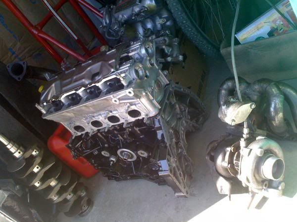

#185081 i have a jdm b16a in my garage the block and head are perfect i have a eagle chromoly crank, ferrea valves, and more
i want to use it for a NA build
but here it is the turbo was an ebay and is gone.
i want to build it but what all should i use i want ctr oil and water pump,
any reccomendations on pistons and rods i should use?
By blk92hb
#185166 you dont need a ctr water pump its the same as a stock b16a pump. the ctr oil pump is the same as a itr pump so it dont mater which one you use. the ? is what are you going to use the motor for dd, drag, auto-x what is the stroke on the crank is it a stock b16 stroke or is it a b18 stroke
