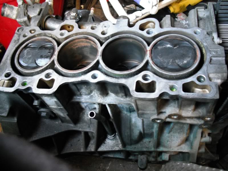

#200580 askin about the rust inside the sleeves, is it fixable or how bad is it? :eh:
By blk92hb
#200584 Yes it is all you have to do is get it honed or bored over and you should be ok
By Quence
#200622
VerLee24 wrote:might even get away with just deglazing yourself
http://www.youtube.com/watch?v=_SzGFDmUaic
i just finishd talkin to my mechanic and hes was doing that
to my boi's ls block. going in for me too.
thanks for the feedbak both!
