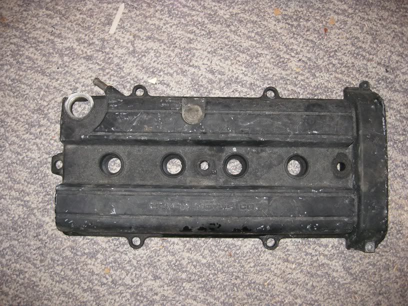

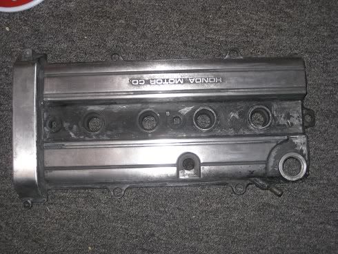

#232010 So i got a valve cover off a fella i know in st johns.He gave it to me.Here is two pics.I am doing it with wrinkle red. Hope you like it so far.
Its nonvtec but what can you do.Vtec b series are brutalllll to get around here.

#232095 no. I knew i should of clarified it a bit more sorry about that.What would be the easiest way to get in between the spark plu holes? It is getting hard to clean up :thumbdown: Any one have any suggestion on prep and paint ? that would be great thanks.

#232134 i am using a flat top screw driver for the harder places now.I picked up a can of "rust check" red oxide sandable primer.It wil be easier to cover with wrinkle red with red... Right?? Do i spray it then bake it then spray it then bake it again.. Or make it thick then bake it and done?? I know how to sand and spary paint but what grits for best adhesion and the process i get mixed up 8)

#232196 ah aight lol bout to say haha. get it sand blasted.

#232680 question has anyone primer these before paint?

#232690 aircraft remover will be your best friend in cleaning that and yes i paint alot lol and i always use a coat or two of primer then i use at least 3 coats base then a coat or two of clear check for "orange peel" then into the oven it goes for an hour

cjw_89 wrote:i am using a flat top screw driver for the harder places now.I picked up a can of "rust check" red oxide sandable primer.It wil be easier to cover with wrinkle red with red... Right?? Do i spray it then bake it then spray it then bake it again.. Or make it thick then bake it and done?? I know how to sand and spary paint but what grits for best adhesion and the process i get mixed up 8)
Spray 3 Heavy coats. 10 mins in btwn each other.. and then bake.. I did mines. with no primer... dont need it..

#232795 i can see some commotion here.My buddy never primed.But if im putting in 4-5 hours of prep work its just as well to shoot some red oxide on it!

#233138 If you use a primer then use something like duplicolor engine primer, its high heat.

#233425 i think i may skip the primer.You guys say it is not needed :thumb: |
