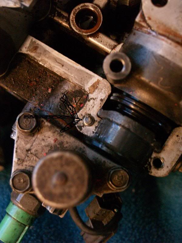

#106703 i took off the head of my b16 and this is what i found. How am i supposed to take these off cuz im pretty sure theyre torqued pretty good? Also where can i get a replacement for these?

#106720 Ok a few things that might help, here is a link that Is Very Very informative on this very topic
http://www.asashop.org/autoinc/may2003/techtotech.htm
Tools you can use
http://www.brokentap.com/easy-outs.html
http://www.nextag.com/Powerbuilt-20-Pc- ... rices-html
And last but not least, THE Standard for Head Studs and Misc stuff ARP!
here is a kit I found online, it's up to you whether you get it from here or somewhere else, I think I've more than pointed you in the right direction.
http://www.nolimitmotorsport.com/prod/arp-208-4601
Have fun and take it slow.
#106801 those shouldnt get that much torque on them.
Thats one of the cam cap bolts.
By petecivic
#107698 I had the same problem but worse than that but with a mig you can weld a little by little on top of the rest of the bolt a far as you get something to turn it with a vise grip... :thumb:
By 95projektvic
#107792 tap n dye set
and a drill
