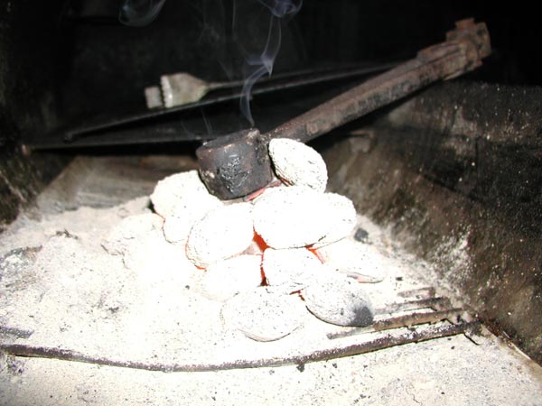

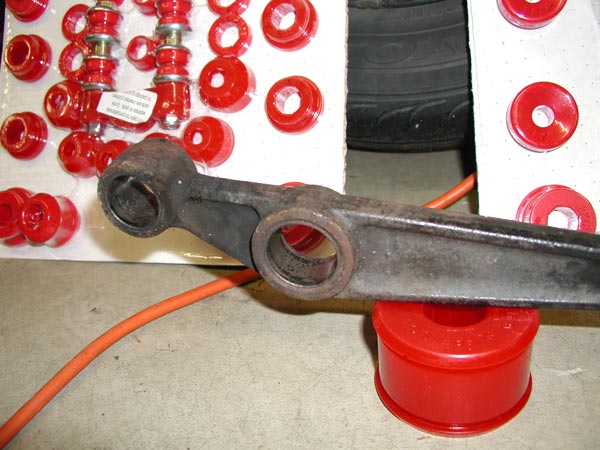

After you make sure you have all the bushings and sleeves in your kit, put the bushings in the freezer and let them sit. They will ever so slightly shrink from the cold = easier to install for the tight fit.

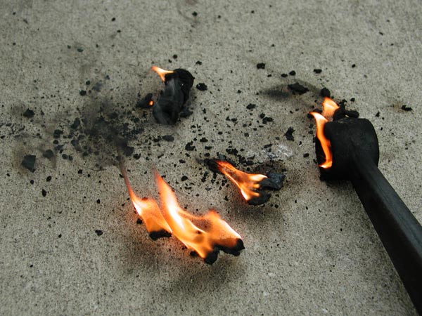

Pick a bushing and start torching it with the propane torch. This makes a mess and lots of black smoke. A flat head screw driver is handy to poke and scrape out some of the burned rubber.
Also for a piece like the rear control arm, I just removed it and put each end in the charcoal grill on a pile of red hot coals. 10 mins later most of the bushing fell out on its own when I picked up the arm (with gloves!). I let it cool and got to hack sawing!

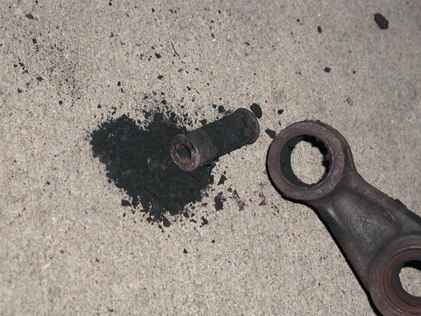

Depending on the bushing, there may be a metal sleeve around the outside of the rubber which was pressed in by the factory. Saw through it in a couple spots. Next hit the edge of the sleeve with the hammer & chisel and it should start sliding out. It is easiest if you put the whole piece or control arm you are working on in the vise. By the way, you have to install the blade on the hack saw after you slide the blade half way through the bushing. Then tighten it down, the blade will be trapped inside the bushing and you can cut away! After making a cut or two, start banging the sleeve out by hitting the edge with a hammer & chisel or punch.
This pic shows the thin metal outer sleeves left behind after burning out the oem bushings, these are what you must cut to remove.

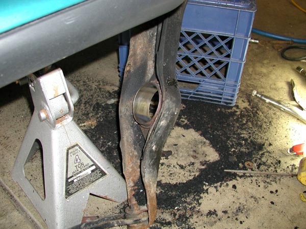

This was the Rear Trailing Arm Bushing that was not included in the Master Kit. It was by far the most difficult to install because I did not use a vise. That would have meant removing the arm from the car and disconnecting the brake and parking brake.
When Installing the new bushings, remove them from the freezer and be sure you have the right one for the control arm you're working on. Align the control arm and bushing in the vise and start clamping down slowly. If the bushing starts going in a little crooked, poke in the side that is coming out with a flathead screwdriver. It doesn't always work on the first try, I even had a couple pop out and shoot over my shoulder across the garage. One even got me right in the forehead, so watch out!
The kit came with lots of grease, I didn't even need it all. Use it if it is there, I learned that you may get some squeaks down the road. Also the Red bushings are more prone to squeak than the Black ones. I read later on that the Black ones are impregnated with Graphite. So buy the Black kit if possible.

yo dude, nice right up. i'm just about to install the rear trailing arm bushing on my EK(got linked here from honda-tech) wondering how exactly you got the bushing out? propane torch? and did you need to remove the outer metal shell completely? also what did you do with the centre metal rod, with the 2 holes to attach the bushing to the chassis? do you just remove it from the old ones and stick it in? or does it need to be bonded or something special?

I removed the old bushing by burning it out. It is a long process, I used a propane torch. After burnung for a while, I would scrape out the burnt areas with a scraper, then repeat with the torch. I did all this with out completely removing the arm from the vehicle. The metal pin that goes through the OEM bushing will need to be re-used. You'll have to cleam the remains of the OEM rubber bushing off of the pin and grease it up and put it in the new bushing. These main trailing arm bushings were harder to install than any other bushing I did on the car.... Lots of swearing at them!

no, the rear trailing arm bushings were a separate set. they were about $20 for both and came in the little yellow box in the first pic. If I did it again, I probably wouldn't even buy those 2 bushings. they were such a PITA to install.
