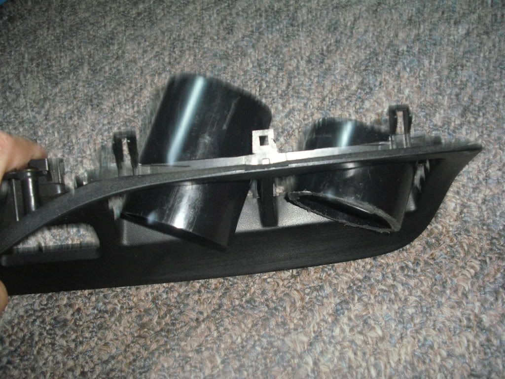

2: Cut your PVC piping to about 2 inches in length this measurement doesnt inter fear with any thing behind the vents notice the long one it was the first one i cut it was to long it hit the vent behind it so it wouldnt sit properly so i cut it down to 2 inches and it fit way better

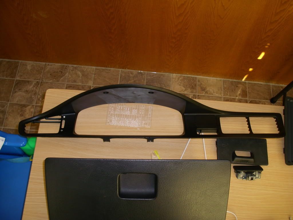

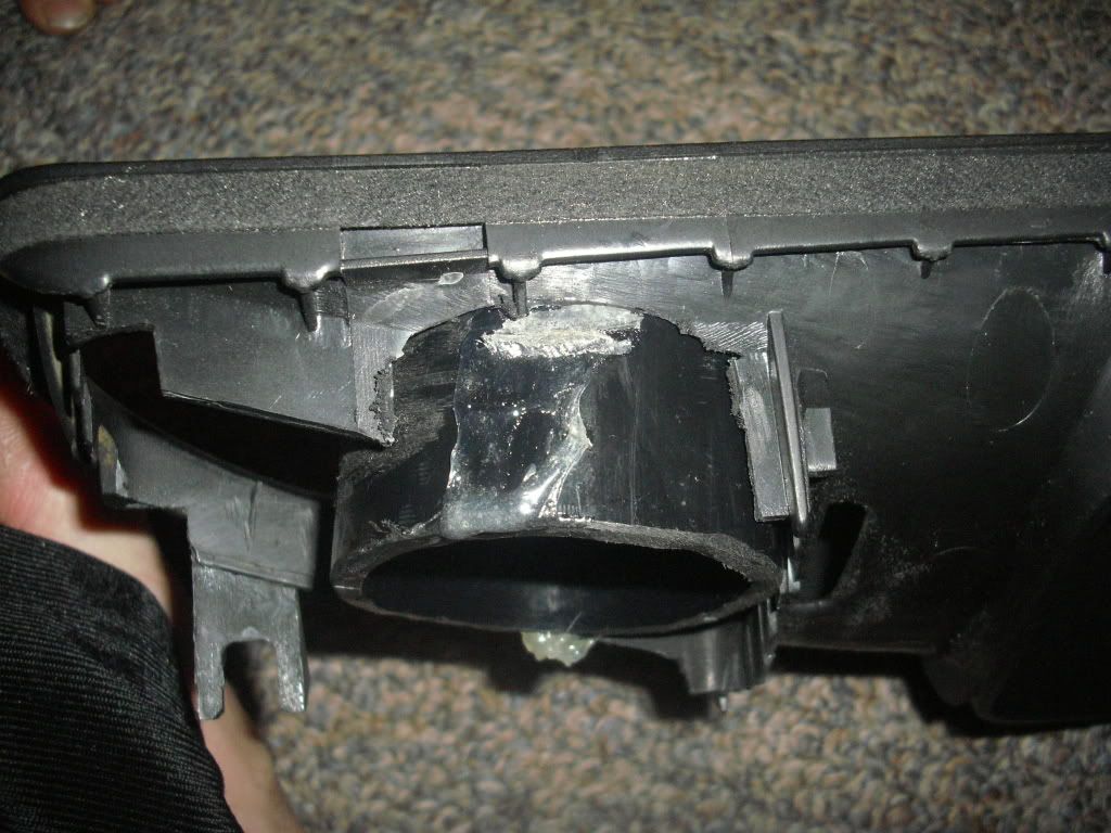

3: Once you have it out, remove the vent fins from both sides using the rotary tool makes it a hell of a lot easier once that is done you should have something like this
4: There are little vents that are attached cut them off and sand them smooth
5: Now we need to fit the tubing in the spots where those vents were
for this part i took the rotary sanding drum and sanded out a groove on the angle i wanted you are going to have to run to your car and set the angle of the tubing where you want it to sit

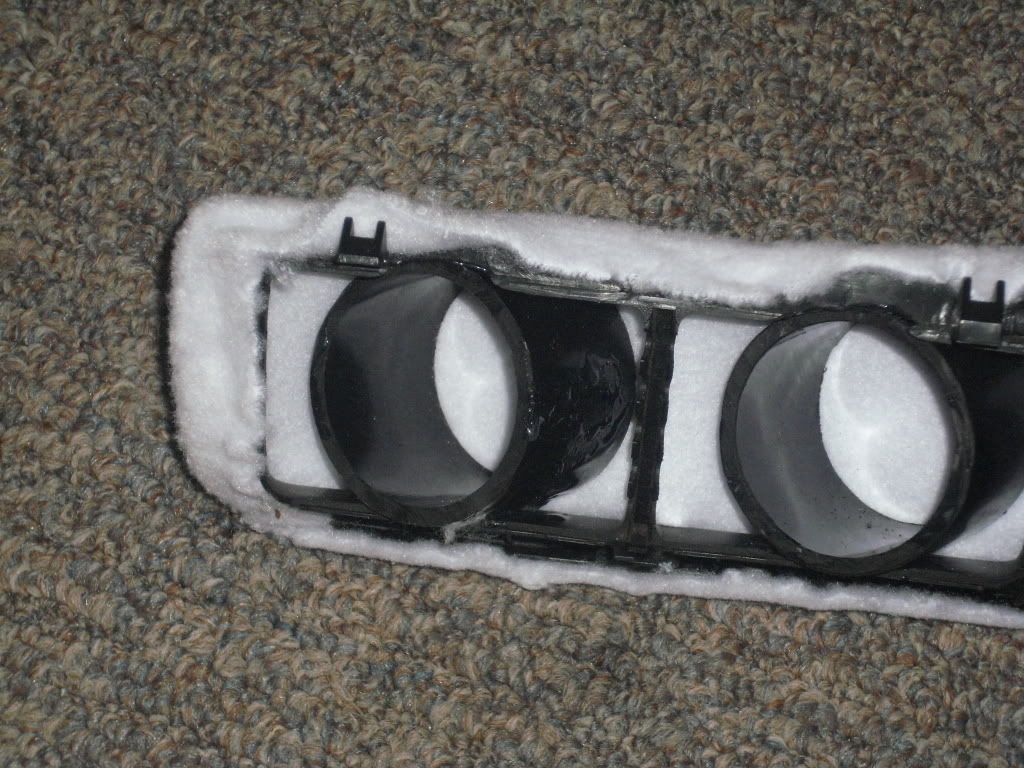

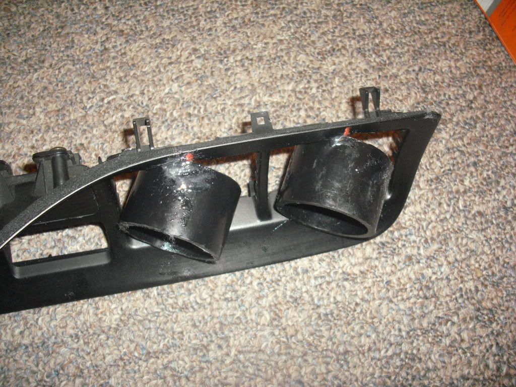

6: Once you have fine tunned the tubing it time for epoxying them in place. once it has mixed let the epoxy set a bit till its a lil bit thick put it on the tubing and then on the groove should stick pretty firm but you still ne to hold it till in is hard enough not to move. mix up enough to do one at a time,

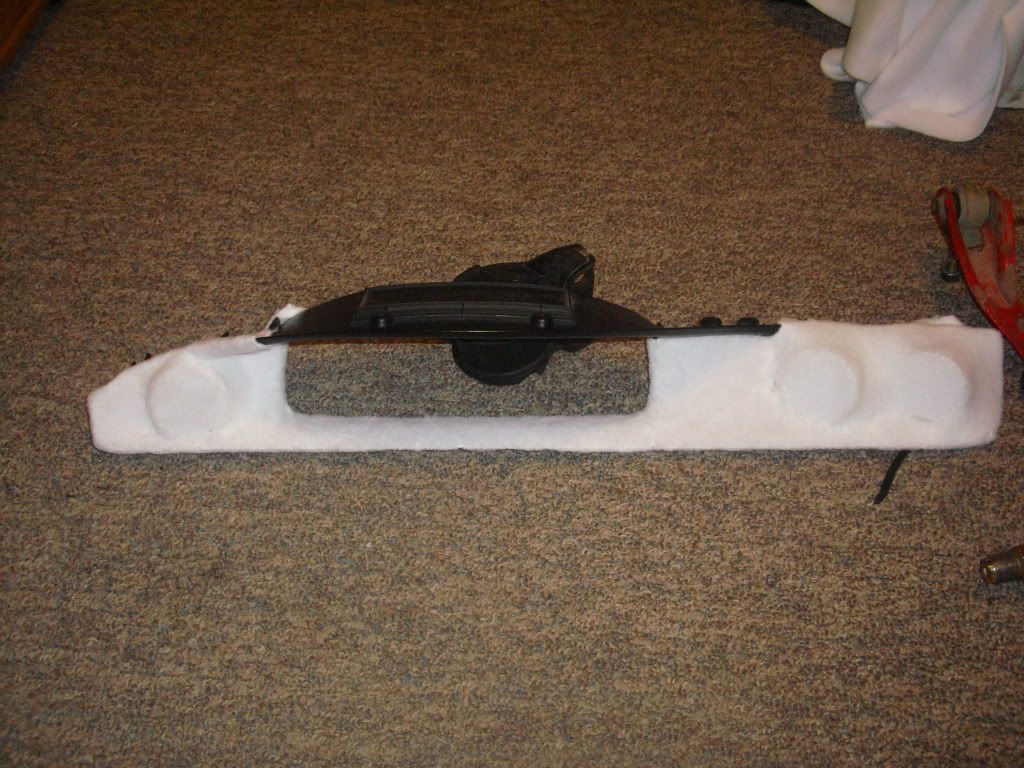

7: Once the Epoxy has set enough that the wont move you can start covering the housing with your fleece (i use fleece becuase you can stretch it over objects great for custom sub boxes)

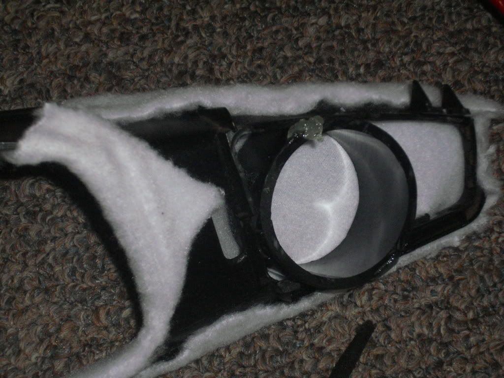

8: Start by taking your crazy glue and applying it to the ring first then apply the fleece then start shaping it by stretching and gluing the cloth in place dont need alot just tack it basiclly take you time start from one side and work over to the next ring stretch a lil bit the glue it and so on till you like the way it looks once everything is secure trim off all access material on the back
Notice i covered the hazard light button place dont worry we will cut it out later

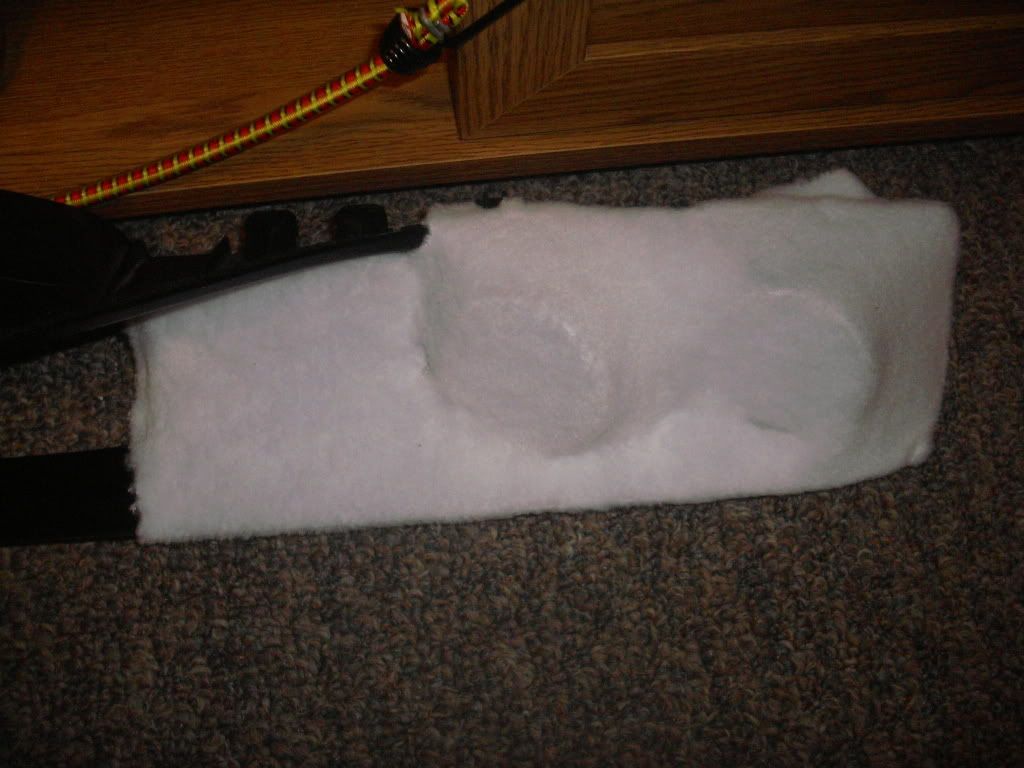

the back of the right dual pod
the back of the left single pod

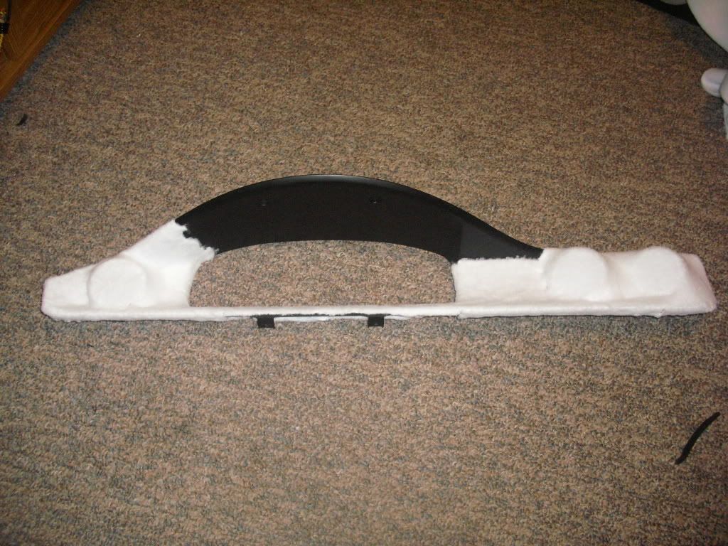

Once your finished you should have something that looks like this
