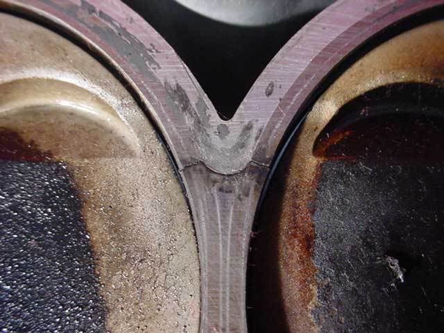

I'll tell you where I get my info......the shop I work at!! I get my info from the countless damaged B20's blocks sitting around my shop. I get my info from all the pissed off customers that are sorry they ever did a B20.
B20's have thinner walls than all other b-series engines. 6mm seperates each cyl, where all other b series' have 9mm seperation.
the b20 casting technique is also different from all other b-series castings.
this accounts for its weakness in comparison to the other b engines.
Here's even a pic to prove my point, so go try your attempt at flaming somewhere else, cuz that shit dont fly with me.
Here's even a website that breaks the B20 down....
http://dwolsten.tripod.com/articles/jan96a.html
