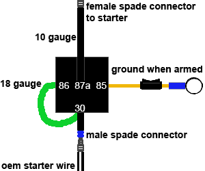

Pull this connector off the starter and re-route it towards where you will be mounting your relay. Extend this wire by crimping a male spade connector on some 10 gauge wire and connecting it to the starter wire. Tape the connection. Wire the relay as shown in the diagram below.
start-kill relay diagram
If you've been following this site you should be very comfortable with relays by now. If not, go look at the fuel and ignition kill pages. This is exactly the same thing, just a different way of connecting to the wire without having to cut it. As usual, you can connect the relay to your alarm's ground-when-armed output, or you could wire it to a manual switch.

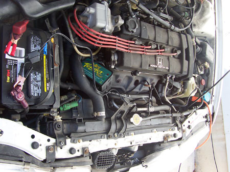

finished start-kill
This is the final result. Just make it as inconspicuous as possible.

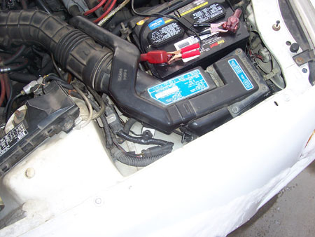

trickle charger
This is how you safely store a vehicle w/out the alarm draining the battery dead. You can get a "smart" trickle charger from Summit Racing, the dealership, or the parts store. It's safe to leave it hooked up to your battery for a long period of time because it won't overcharge it.

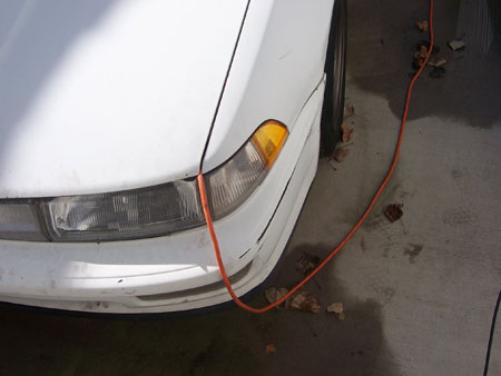

extension cord
Tuck the end of the extension cord under the hood. If a thief cuts this cord, it will blow the circuit breaker in the house. But even if no one notices, the backup battery is going to keep the alarm alive for quite a while.
Try to imagine a scenario in which a thief cuts the extension cord, potentially shocking himself. The battery charger ceases to function, yet the car battery will last several weeks. Now the thief returns to find that though the car battery is low, the alarm continues to function thanks to the battery backup. Another week goes by. Hopefully by now you have returned from your trip, or at least someone in the house has noticed that your garage light and half your kitchen electronics aren't working due to a blown circuit breaker. Upon investigation they will find the cut extension cord. Failing that, the thief would still have to bypass your car alarm's normally open kill circuit as well as the kill switch. It's not going to happen.
